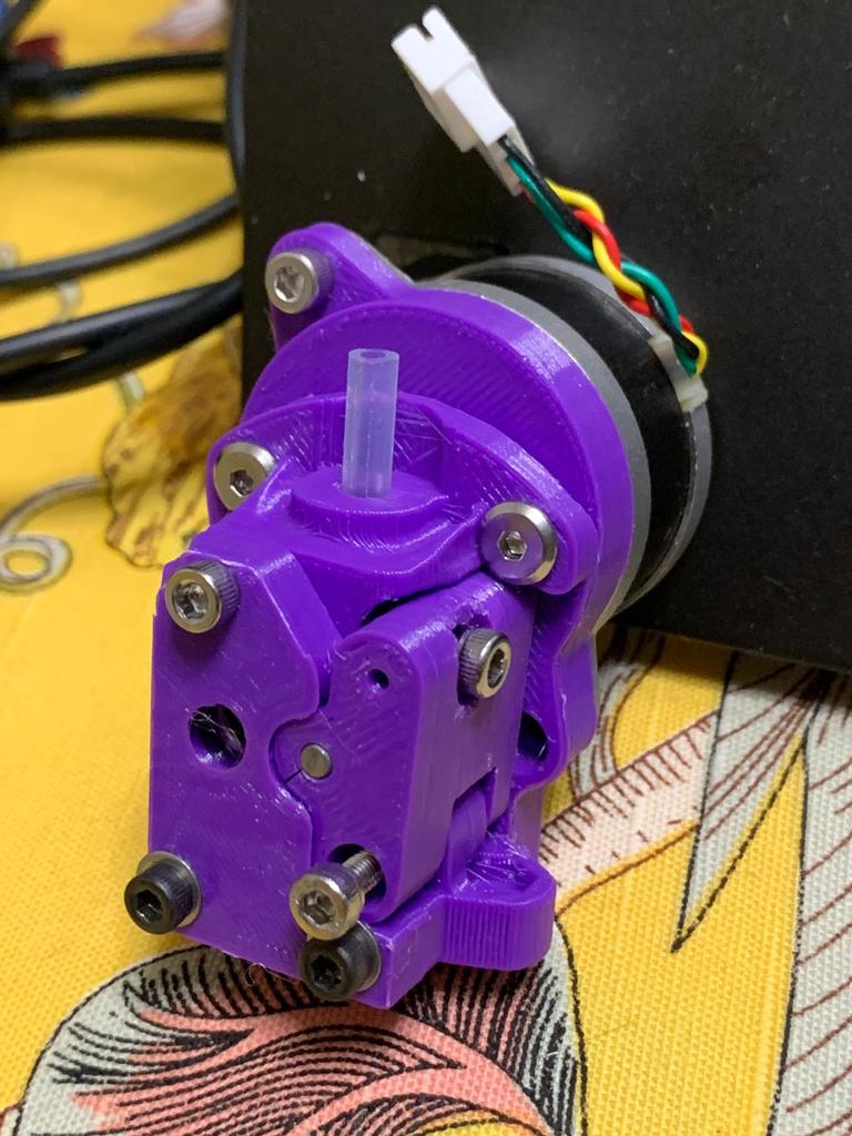

Decem Extruder v2.1d and Decem Delta(From kossel mini) ,TPU 98A 150mm/s
本帖最後由 xo_ox 於 2022-4-30 01:05 編輯

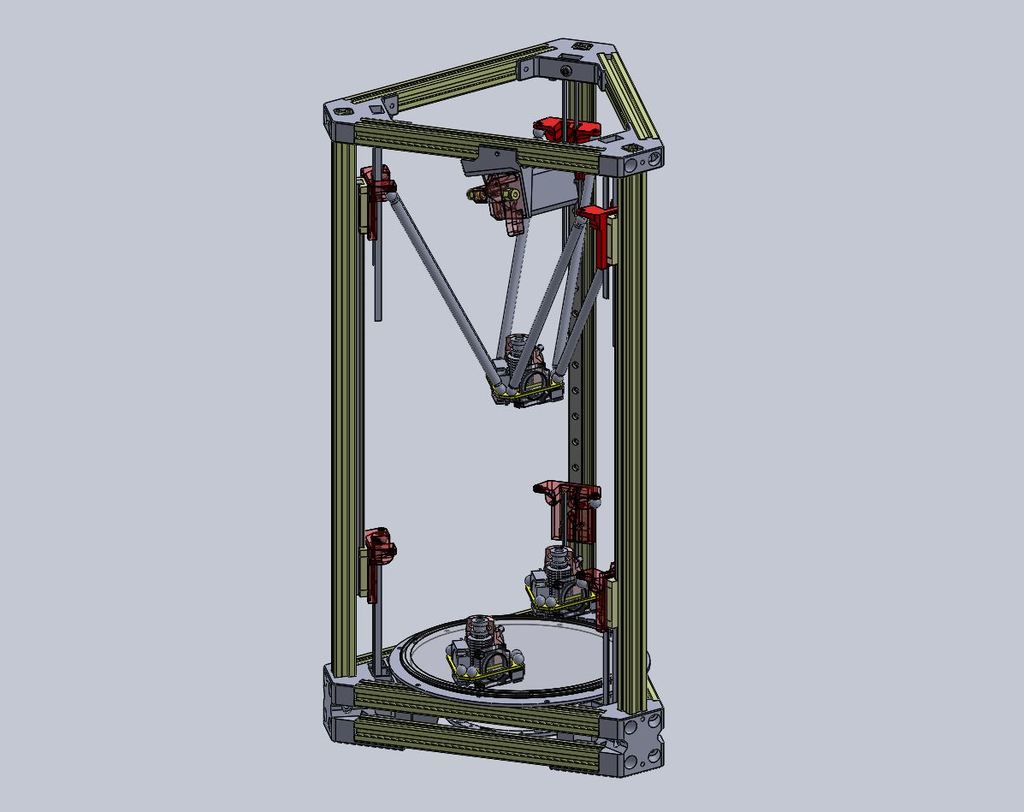

Decem Delta
https://www.thingiverse.com/thing:5171348

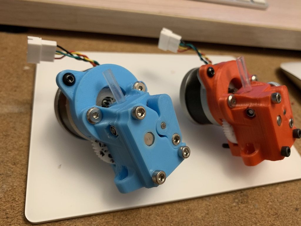

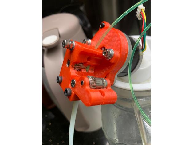

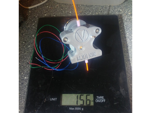

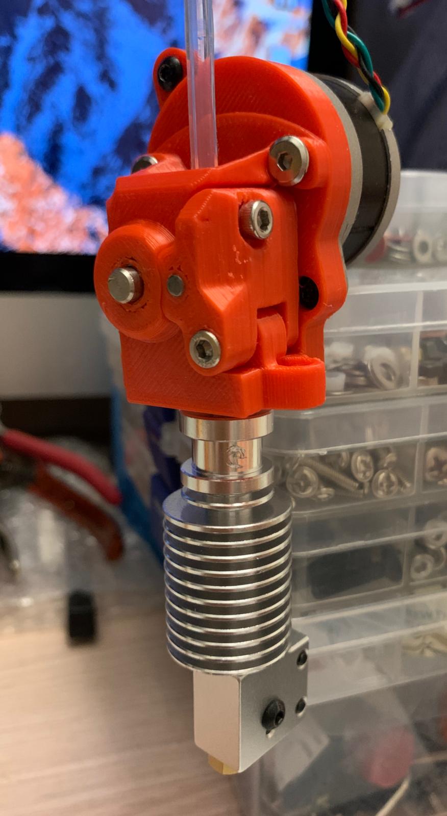

Decem Extruder v2.1d (BMG reload) 1:5 gear ratio
=v2.1d====================================
https://www.printables.com/model ... e-bmg-reload-tpu-85
added a connection parts https://www.thingiverse.com/thing:4863845
=v2.1=====================================
v2.1a.JPG [attach]2263924[/attach]
https://www.hkepc.com/forum/redi ... 83&pid=40367888

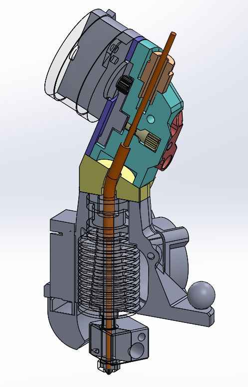

=V2======================================
Updated 2021-05-16 V2 simplify(優化/簡化)
V2 01.JPG [attach]2263735[/attach]

是否用BMG 1:3 哪一套齒輪?
本帖最後由 xo_ox 於 2021-4-13 00:06 編輯
是否用BMG 1:3 哪一套齒輪?
ustkl 發表於 2021-4-12 22:35

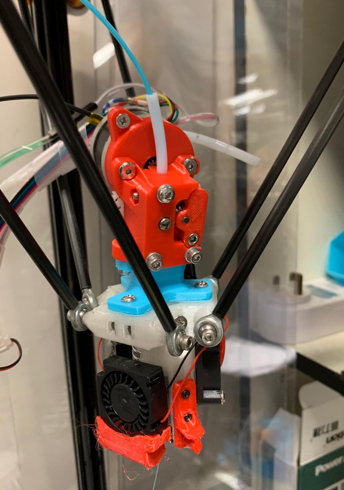

yes, and change to 0.5 10T gear motor
plan to use in delta Direct Drive
齒輪比變咗1:5, 嗰隻圓餅應該都夠力推.
本帖最後由 palpatrick 於 2021-4-13 09:19 編輯
xo_ox 發表於 2021-4-12 22:53
裝好咗試下咁印

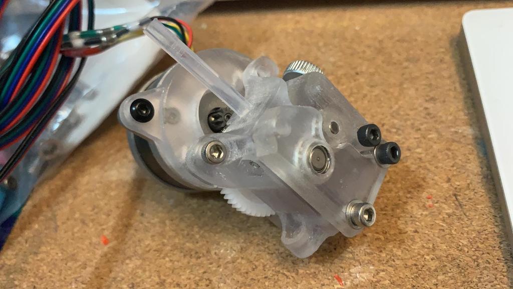

本帖最後由 xo_ox 於 2021-9-6 22:39 編輯
ustkl 發表於 2021-4-13 00:32
1:3 also work and printing/testing
"TPU" at 40~50mm/s,
but the wings of this design hit the Rod ...
direct drive delta, 個effector面積不能太細, 每一對竿嘅距離要盡量拉開, 如果唔係會因為重量慣性而變得唔穩定.
preparing to go...

師兄,請問你隻圓形摩打係乜嘢model?TB之前只係揾到D冇gear 的。 ...
t9097 發表於 2021-4-14 18:59
    Wan tai, similar to LDO motor
