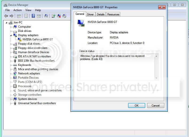

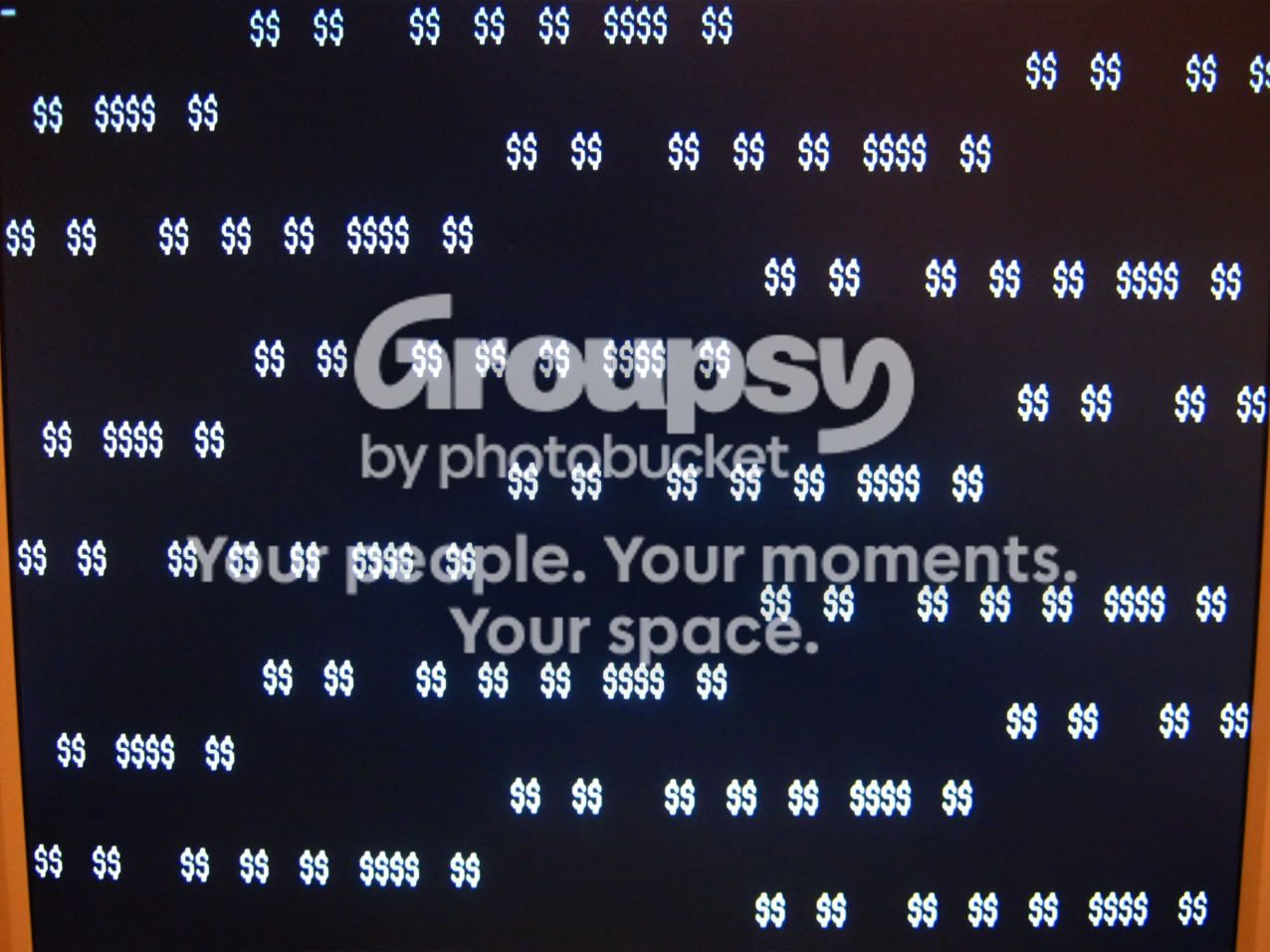

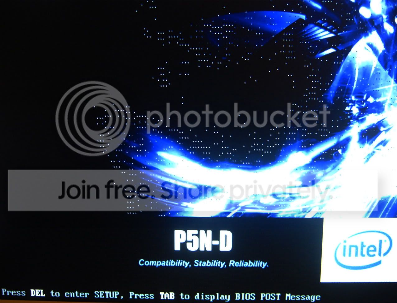

病徵: 開機花畫面(直間條,爛字),可入windows ,但load唔到個driver~ 打唔到機...update driver無效,
插落第二部機無無效(排除psu, mother board  , windows , driver 問題),update bios無效....即告陣亡....
