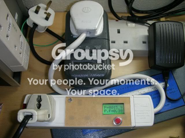

度power factor, brennenstuhl 成日都 show 0.99-1.00, 亂點一通, 求人不如求己. 終於用80C51 + 2粒 12-bit ADC整咗個wattmeter.:

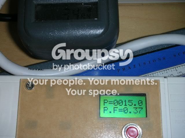

度notebook 嘅 power supply, 都無PFC,  brennenstuhl 都話Power Factory 係0.98, 我個就話係0.39嘞.

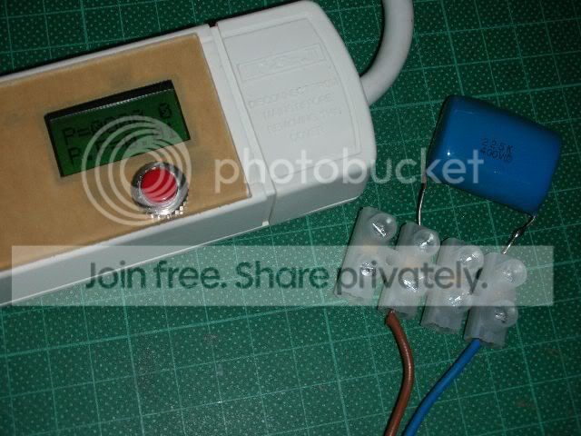

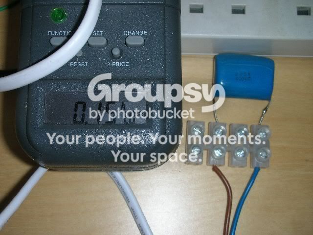

度一粒2.2uF電容接在AC line:

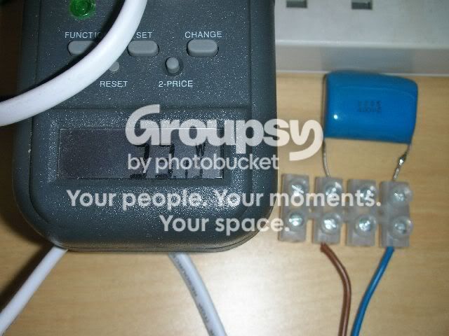

brennenstuhl 都話Power Factor 係1.0, 你地信唔信呀.
重話功耗33W !!!  都痴線, 係真, 粒cap 都爆咗啦.
我個就話Power係0.0W, Power Factor 係0.01 嘞. 有1% resistive loss, Power <0.1W, show 唔到,  都合理啩.

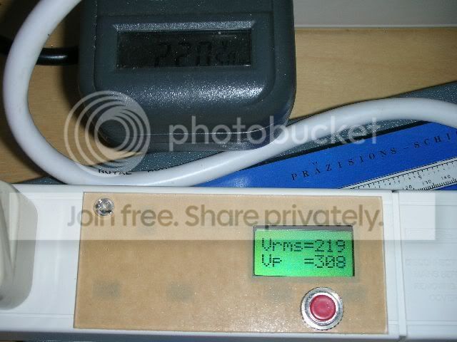

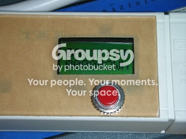

我個wattmeter有4個display mode, 睇AC Vrms, Vpeak:

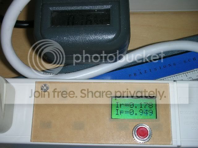

睇AC Irms, Ipeak:
睇Power, Power Factor  :
計時, 計W-hour (>1W先計):

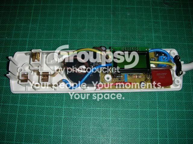

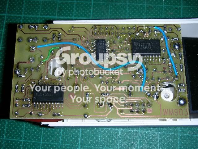

Wattmeter 內部:
brennenstuhl 用current shunt 黎測電流, 我用current  transformer, 唔洗加放大都出到+/-2Vp, 又無電壓降 , 呢隻current transformer 都大咗D, 係50A, 現在primary 用咗2圈. RS 都有細隻D 嘅20A current transformer 賣, 不過要買5隻起.
不過current  transformer度唔到電流嘅DC offset . 度switching power supply就無問題, 因為係全波整流, 無DC offset .
板後可見到心臟: NXP 嘅P89LPC934 (80C51 core) + 2隻TI 12-bit ADC TLC2558, 一 粒度電流, 一 粒度電壓, 要同步至度到true power:

之前有人整個AC current meter 就以為係 wattmeter.
果舊野係我整既
#1講到明度唔到power factor
而且我只用佢泥參考
除非好似你咁走去度粒電容,否則一般產品power factor都上到~0.8
