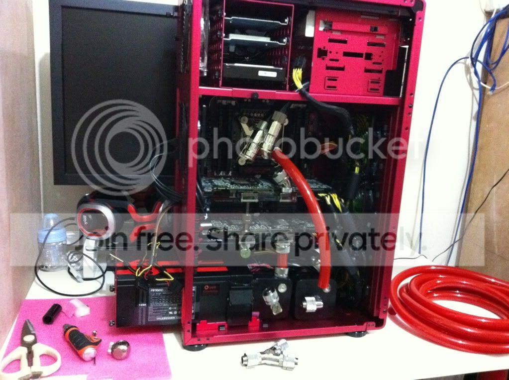

   睇佢個360排係 single pass ~~~ 因為420既single pass 好似未有廠出(可能 )
如果行single pass 就無死水位同 airlock
水箱>360>泵 這部份,可能有問題。
360排內部是U設計的,可能有airlock不好排空氣和死水位。
因為泵是吸360排的水。。。不是推又有排的U位。。。。
除非瀑布水箱加滿水....但會沒看頭。

睇完你幅水道圖 怕你下面水冷排泵同火牛吾係太夠位
我自已用 sliverstone + SR-1 280 計埋D POWER cable  ...
jaywalker99 發表於 2012-2-10 14:09
    我都有依個問題, 最後既方法就係將隻牛牛推出小小.....
左下角睇到

Are those DDC pumps? You can get the XSPC dual bay DDC pump res.  Koolance also has two, single and dual bay, but the current revisions are too hard to bleed when using dual pumps.
回復 100# wanyiuchung
I agree with you.  水箱 outlet should always go to pump inlet to ensure the pump will never run dry, otherwise it's going to be really hard to prime the pumps during initial filling and risk damaging the pumps.

佢個360排唔係 single pass 咩
我第一眼以為佢行single pass,如果two pass既話,
佢成條道 真係大把野要唸過
