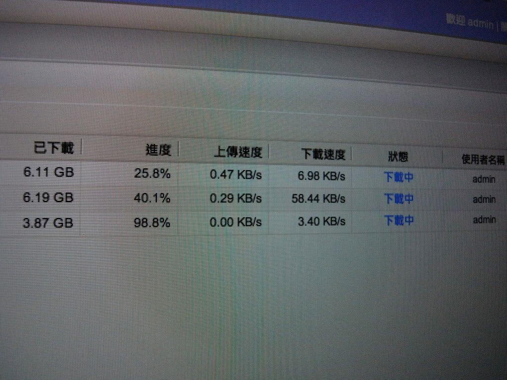

dear dolpli hing,
I am using DS109, I just set the port forwarding :
http(TCP80)....etc
the speed is still hopelessly slow :(
are you using 300NH too?
pls see photos:
could you kindly advice what to set to get max. speed?

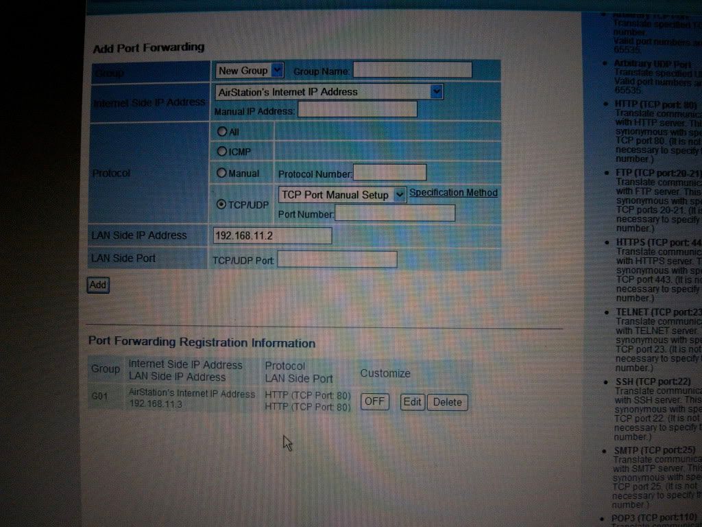

To: 2698
I am using G300NH too.
It is no use to forward port 80 for BT. Port 80 is for photo station & web station only.
Instead, you should:
1) login synology and check the port number of BT you set (default port setting is 6881 ~ 6890 for firmware v2.0.1-3.0401 and onward).
2) login buffalo G300NH & port forward the above port numbers, both TCP & UDP, to you Synology diskstation IP.
BTW, in your captured photo attached, I assumed that you have fixed the IP of your synology diskstation to IP 192.168.11.3
[ 本帖最後由 dolpli 於 2009-7-25 07:06 編輯 ]

I tried the port forward 6881-6890, seems working, wait and see, and will report later.  The synologyDS109 bandwith should be set in the "network" of the DS manager, right, I enable jumbo rate and set MTU at 9000, am I doing right?
thanks!
