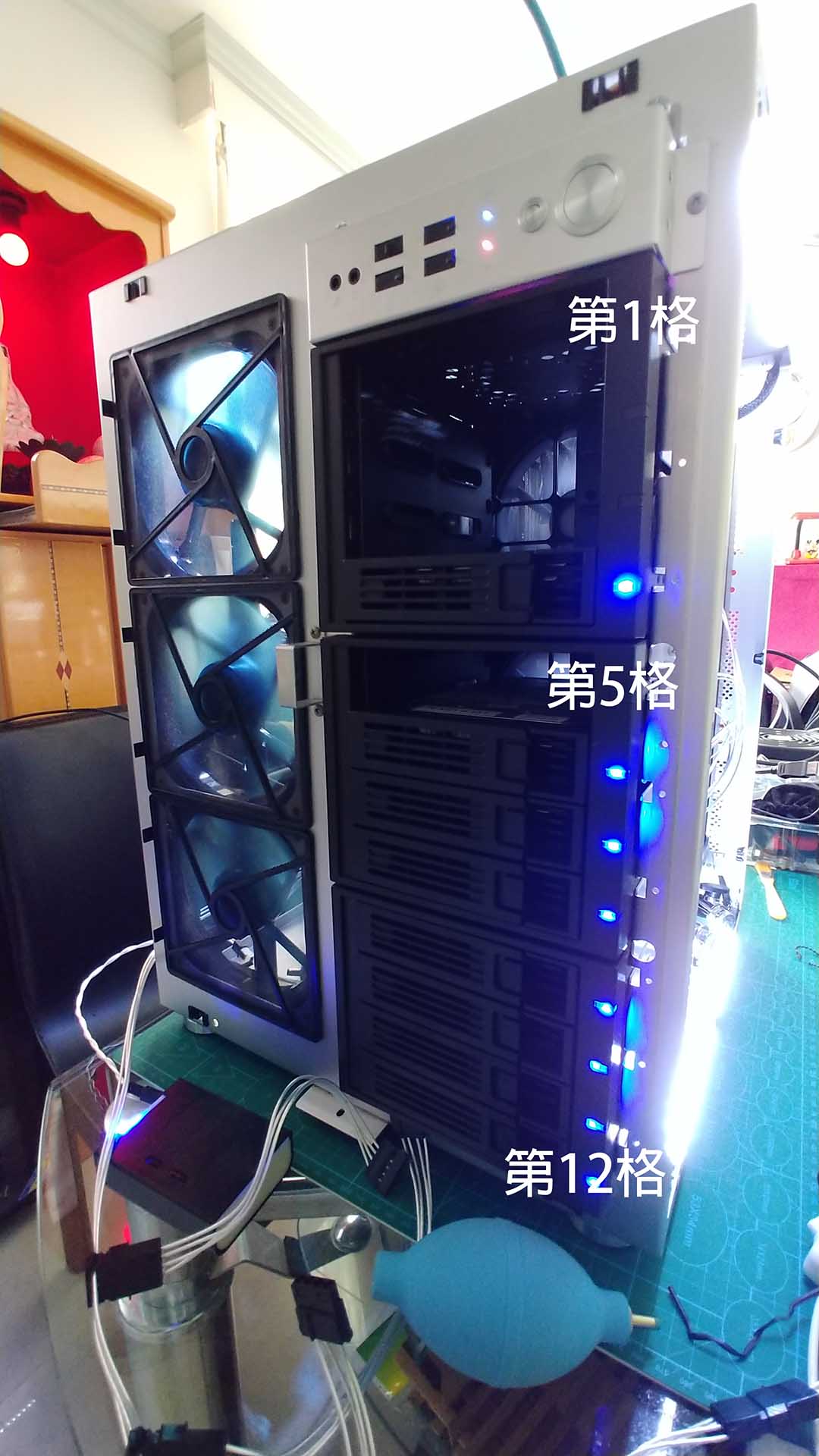

唔知點解攪好部機後再駁番好D HDD就死左隻slot 0(第5格)
slot 0 - 7 = 第5-12格

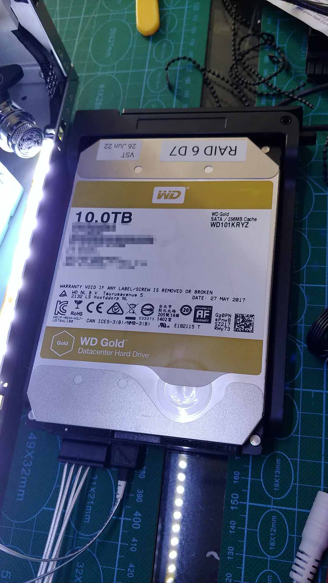

不過見有時間就拎左隻slot 0去第二部機行WD個check tools先確定一下壞碟
結果行完無問題,我再full format一次都冇問題,
S.M.A.R.T.都好正常,再插去第三部機都係一樣無問題

咁我就忽發其想張cable個port1同slot 0 hdd換去第1-4格試啦,
結果1-5格都係failed,
既然我已經backup晒成個raid6,

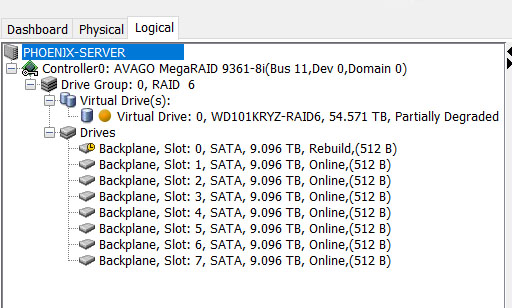

咁我就膽粗粗試下拆左slot 7(第12格),換左隻slot 0去第12格
結果slot 0成功係第12格rebuild完冇error,

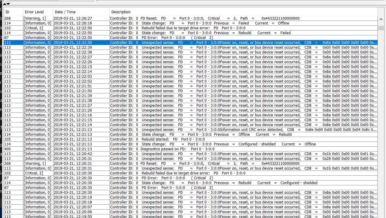

之後同樣地我張slot 7果隻插晒1-5格,按左start rebuild無耐已經failed
不斷彈error: Power on, reset, or bus device reset occurred
我google下搵到有人同我有類似既問題,
https://www.overclock.net/forum/320-raid-controllers-software/1245974-lsi-megaraid-9265i-unexpected-sense-pd-3-a.html
佢用ice dock 3*5.25轉4*3.5
我就用Rosewill呢隻
https://www.amazon.com/Rosewill-5-25-Inch-3-5-Inch-Hot-swap-SATAIII/dp/B00DGZ42SM/ref=sr_1_4?keywords=hot+swap+hard+4+drive+bay&qid=1553142794&s=gateway&sr=8-4
搵過市面上唯一得呢隻hot swap case係12cm fan所以揀左佢,
佢個問題係插係ice dock就會出呢個error,HDD直插SFF-8643 to sata*4就無問題
咁我就試下,結果真係直插就冇問題rebuild得好順利...
