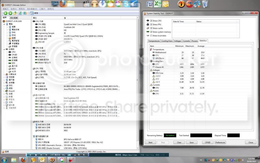

超頻到3.0ghz, 唔知各位大哥認為點呢?
you may try higher the temperature only 27C
外頻 533 ram 1066 cl5
外頻 400 ram 1200 cl5

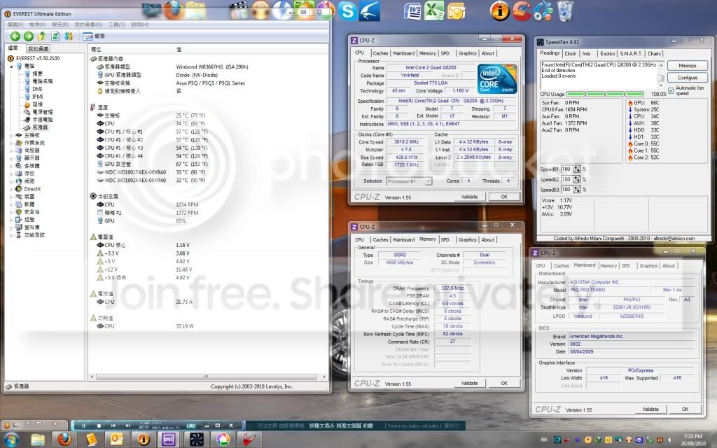

ip4368 發表於 2010-9-21 19:14
i did try higher, but the system became unstable, what should i do
本帖最後由 ip4368 於 2010-9-23 11:04 編輯
回復 4# kachunwong628
add cpu voltage, you are only using 1.16V, try to increse
回復 4# kachunwong628
may be use 1.2-1.3V
回復  kachunwong628
may be use 1.2-1.3V
ip4368 發表於 2010-9-23 18:51
i have changed it to 1.25 v right now, but i would want to know what speed should i get to, should i keep trying, or 3.0ghz is the max?
回復 1# kachunwong628
呢粒U應該可以上3.6以上
回復  kachunwong628
呢粒U應該可以上3.6以上
love19901109 發表於 2010-9-23 23:28
多謝love19901109, 我會儘量試上3.6
3 GHZ低左D喎,有排都未到頂
