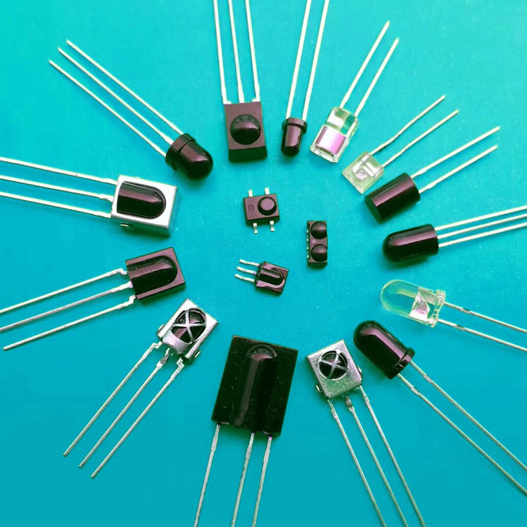

簡單拆機睇下是否用以下類似3腳的紅外線接收IC先, 係就用他錶度度輸出腳看看正常否
咁大牌子又新淨都好難想像會壞IR 接收吧
咁大牌子又新淨 ...

以前拆過150,粒接收係咁嘅樣
Pioneer IR係行40kHz carrier frequency,淘寶睇樣就應該係呢粒
https://item.taobao.com/item.htm ... ;abbucket=13#detail
假如個遙控有光出,可以試吓用遙控對住部機個接收按鍵,用他錶睇吓IR接收Out腳對地有冇電壓改變。
