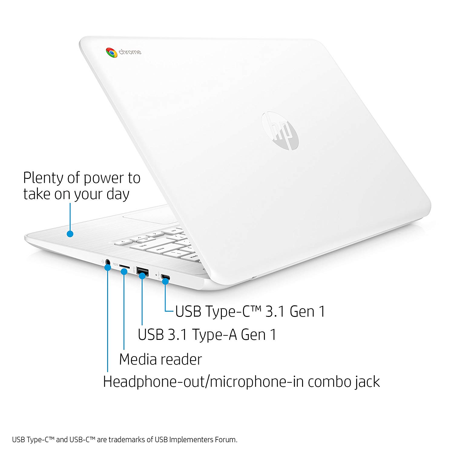

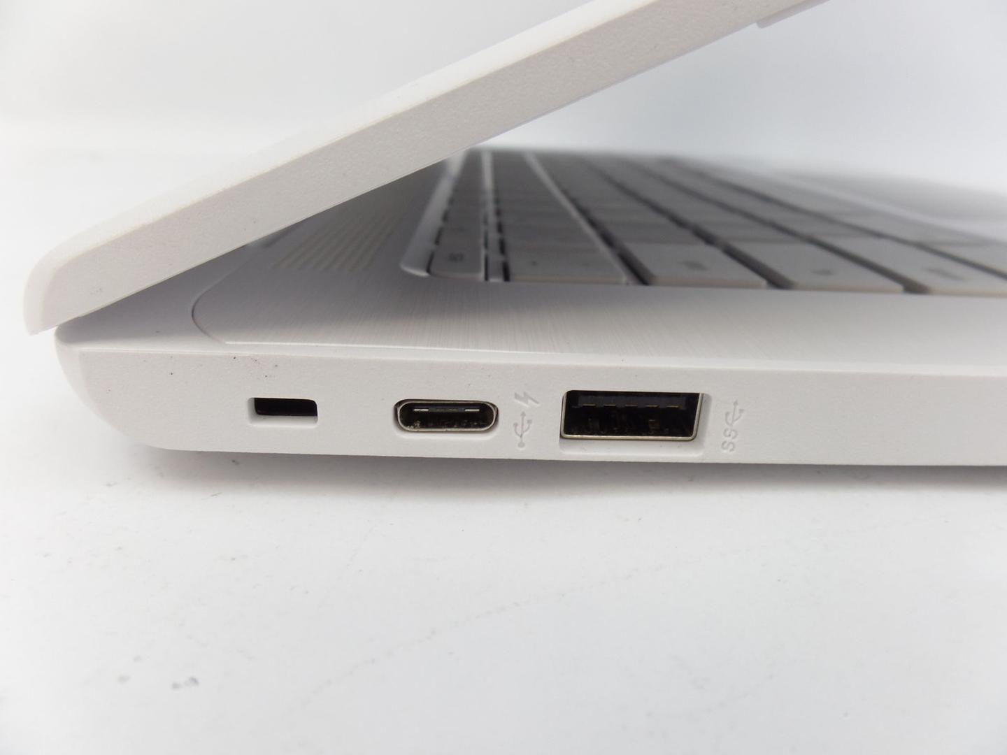

I am thinking about buying a HP Chromebook 14 (4AL78UA)
https://support.hp.com/gb-en/document/c06083140#AbT0
Its product page say:
"2 USB 3.1 Type-C™ Gen 1 (Data Transfer up to 5 Gb/s, Power Delivery, DP1.2, HP Sleep and Charge); 2 USB 3.1 Gen 1 (1 HP Sleep and Charge); 1 headphone/microphone combo"
Can I buy a USB-C to HDMI adapter to connect the chromebook to the monitor?
Can I buy a USB-C to DisplayPort adapter to connect the chromebook to a DisplayPort Monitor?
Thank you.

一般都係轉成 hdmi 多
估算因為多數用 intel 內顯
內顯一般都只會支援 hdmi 輸出
要轉成 DisplayPort 需要增加額外chip
所以哩類Adapter通常費 d
我覺得支援不成問題
