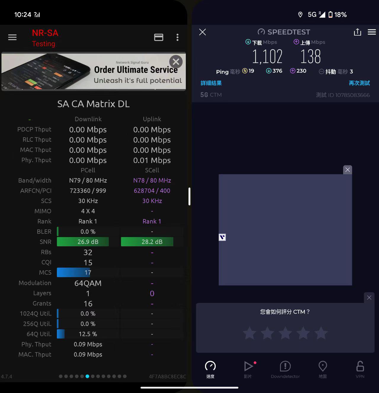

柯士甸站CMHK有n78+n79 (共160MHz)
用CTM卡漫遊接入CMHK試的:
圖片附件: 485404525_1721733242061451_5489510915704709292_n.jpg (2025-3-30 09:54, 107 KB) / 下載次數 25
https://h0.hkepc.com/forum/attachment.php?aid=2471398&k=0af50c2fe7abf384de6cd634e9a6edf5&t=1781503410&sid=1nYcul9z52P
