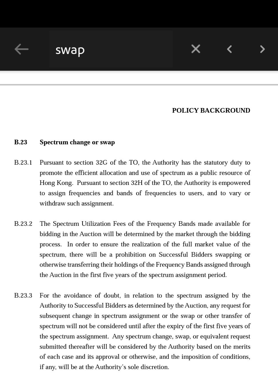

作者: jd2268    時間: 2021-9-24 19:15
can they don't officially swap the spectrum but do it in operation. :p
It is a win-win-win si ...
michaelso 發表於 2021-9-24 15:45
師兄,請好好去OFCA官網搵資料
For the avoidance of doubt, in relation to the spectrum  assigned by the Authority to Successful Bidders as determined by the  Auction, any request for subsequent change in spectrum  assignment or the swap or other transfer of spectrum  will not be considered  until after  the expiry of  the first five  years of the spectrum assignment.   Any spectrum  change, swap, or equivalent request submitted thereafter will be considered by the  Authority based on the merits of each case and its approval or otherwise, and the imposition of conditions, if any,  will be  at the  Authority’s  sole discretion.
圖片附件: Uploaded_via_HKEPC_IR_Pro_Android(4b071).jpg (2021-9-24 19:14, 136.9 KB) / 下載次數 27

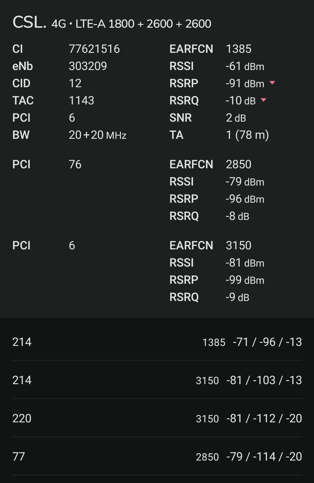

Hello卡,但係很多時候都會load空氣,1800+2600+2600 3ca
圖片附件: Uploaded_via_HKEPC_IR_Pro_Android(d3483).jpg (2021-9-26 11:09, 123.46 KB) / 下載次數 27

既然寫明頭5年唔准換, 我諗所有operators都要跟你呢個表.
不過, SMT個新1250,3仔個新1925同埋CMHK個新1850有機會變成n3或DSS B3+n3,
原因是,新頻譜用作5G不會減少現有4G頻譜數量(CxL除外),
又可以"焗"個的塞緊 4G車既用戶換5G機, 以增加其手機銷量.

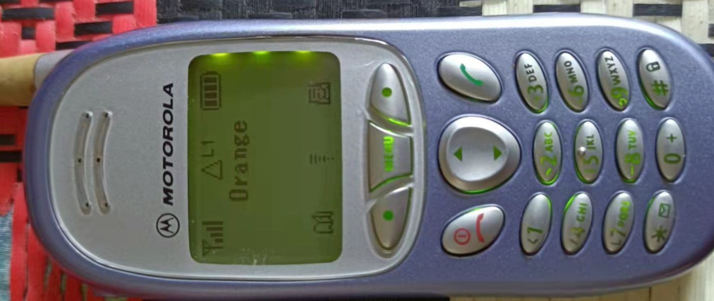

作者: apliucard    時間: 2021-9-29 17:17
今天再拿回20年前手機玩下,又得。
展示最後一夜
圖片附件: mmexport1632906925580.jpg (2021-9-29 17:17, 91.26 KB) / 下載次數 19
https://h0.hkepc.com/forum/attachment.php?aid=2285134&k=e6410782c39eda38e80c48c5cecb7f80&t=1782451582&sid=110YssbMZUz

為CLS既channel 1385騎離既bandwidth 安排(部分地方開足20M bandwidth)留返個遺照
圖片附件: Uploaded_via_HKEPC_IR_Pro_iOS(DB897).jpg (2021-9-29 18:36, 123.08 KB) / 下載次數 16
https://h0.hkepc.com/forum/attachment.php?aid=2285160&k=dba05e3ee8937fe9a6badb9cddb88bc2&t=1782451582&sid=110YssbMZUz

作者: apliucard    時間: 2021-9-29 21:15
本帖最後由 apliucard 於 2021-9-29 21:17 編輯
我都再拿返20年前Nokia 8250玩下,用工程模式睇到Csl. 2G而家只得2條頻道,今晚再用cmhk卡 ...
boot 發表於 2021-9-29 21:11
    csl得900mhz 74個條
今晚感覺同2007年11月關閉CDMA一樣,當晚看著部sanyo冇網
