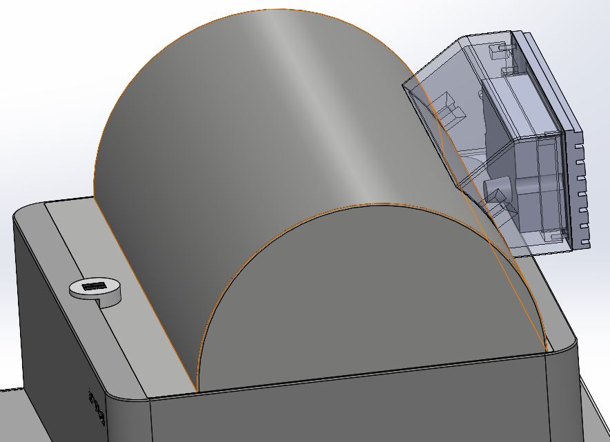

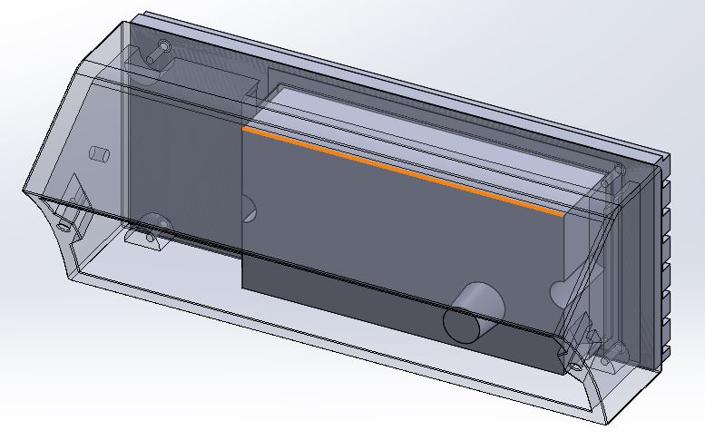

作者: xo_ox    時間: 2025-4-11 11:25     標題: Dehumidifier for Bambu lab AMS by 防潮箱 除湿机芯...
本帖最後由 xo_ox 於 2025-4-14 05:39 編輯
Cut a opening on AMS cover
https://makerworld.com.cn/zh/mod ... a#profileId-1190964
圖片附件: ams02.JPG (2025-4-11 11:20, 61.15 KB) / 下載次數 55
https://h0.hkepc.com/forum/attachment.php?aid=2473392&k=60acba7a74e0ab804feac20aab3b1378&t=1781313118&sid=484xaHGmIZ
圖片附件: ams01.JPG (2025-4-11 11:20, 57.03 KB) / 下載次數 57
https://h0.hkepc.com/forum/attachment.php?aid=2473393&k=136591de711b4b6019bca33eb3eb9916&t=1781313118&sid=484xaHGmIZ
圖片附件: ams03.JPG (2025-4-11 11:23, 74.4 KB) / 下載次數 56
https://h0.hkepc.com/forum/attachment.php?aid=2473394&k=61a3a49ef2d49bc0b72c7596427b2666&t=1781313118&sid=484xaHGmIZ

作者: xo_ox    時間: 2026-2-2 16:54
Finally, I test this unit setup,
This "Dehumidifier" unit only could do/make at RH45-50% ...
but the filament  need under 20% ...
令人難過 ...  : <
