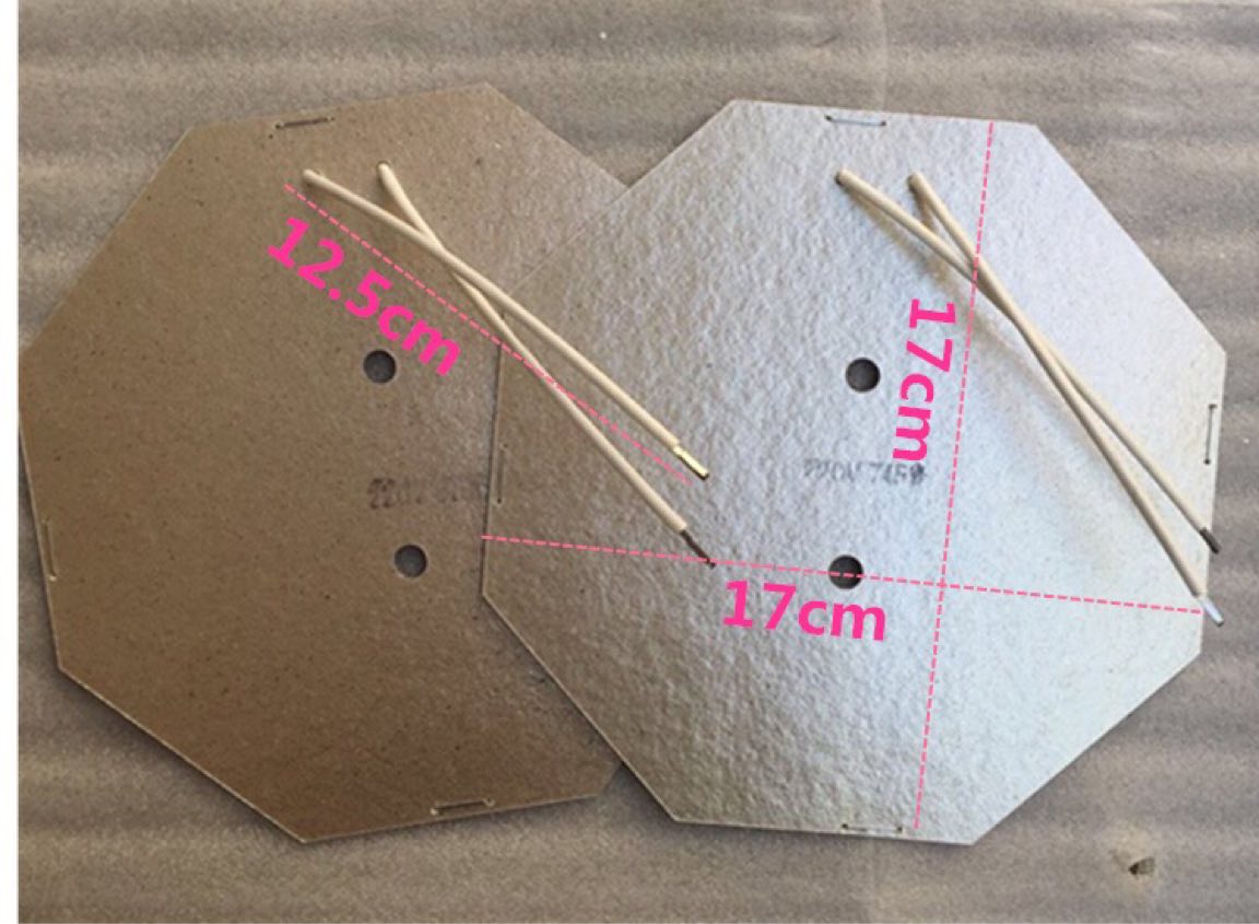

我無意間發現咗一種香港小食用嘅加熱板會啱delta用
600-800W
17cm 直徑
人仔35有2片
圖片附件: Uploaded_via_HKEPC_IR_Pro_iOS(D48AE).jpg (2019-5-31 02:00, 124.6 KB) / 下載次數 66
https://h0.hkepc.com/forum/attachment.php?aid=2129550&k=18fa3d28b96a0bd29ff63fbeba2fefc2&t=1781402254&sid=drQEgStF7M

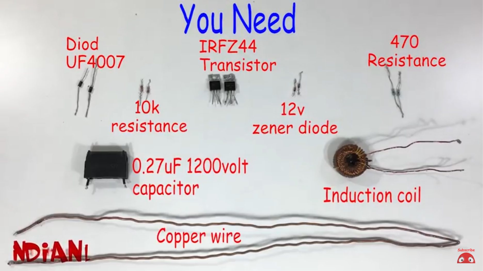

作者: t9097    時間: 2019-5-31 17:22
作者: bam1a    時間: 2019-5-31 18:26
回覆 10# palpatrick
試唔試下搞

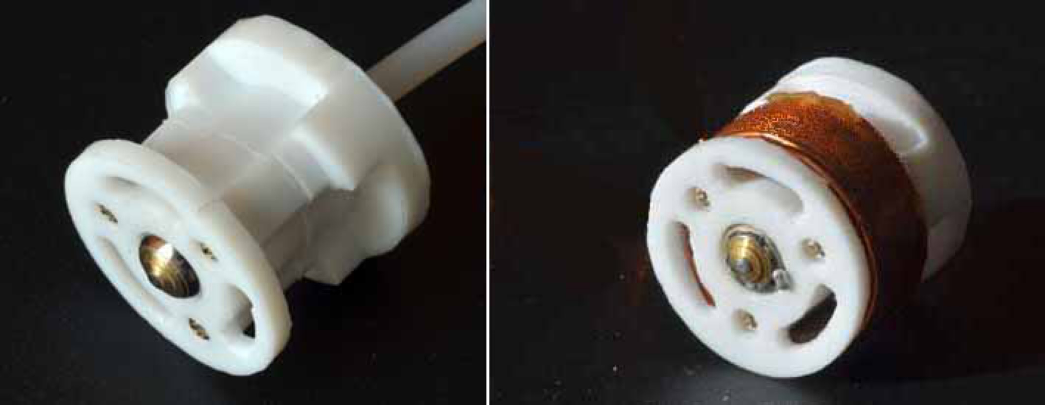

師兄! 試想下下圖個頭加個三角形,只要加兩把吹件渦輪扇,就係delta IH effector!
圖片附件: Uploaded_via_HKEPC_IR_Pro_iOS(DD0ED).jpg (2019-6-2 13:12, 116.74 KB) / 下載次數 69
https://h0.hkepc.com/forum/attachment.php?aid=2130059&k=dc8a87583b0064bdeb29ec835993334e&t=1781402254&sid=drQEgStF7M
作者: bam1a    時間: 2019-6-2 17:08
via ...
palpatrick 發表於 2/6/2019 15:12
但始終都係靠銅產熱,個外殼應該都要靠啲耐熱膠去做絕緣隔熱手續掛
好似Jhead沒落咗之後失咗寵嘅peek材料?
作者: palpatrick    時間: 2019-6-2 17:56
回覆 19# bam1a
我用Google translate翻譯咗 ,日本達友係用CNC車個PTFE(Teflon plate)線轆出嚟!
5-2 Production of bobbin for coil ('15, 04, 08 postscript) The
bobbin supporting the induction coil was cut out from a Teflon plate using CNC 3020 .
It became complicated because the ventilation duct was provided to cool the coil with air.
