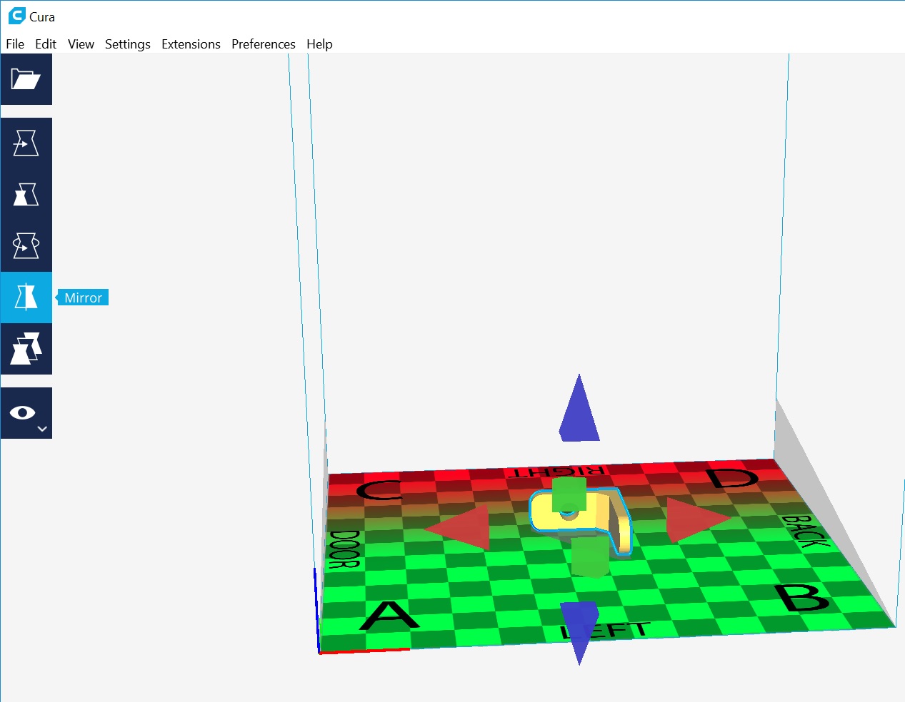

You can choose to mirror the object with the mirror function on the left.
圖片附件: cura mirror.jpg (2018-4-2 00:19, 126.68 KB) / 下載次數 27
