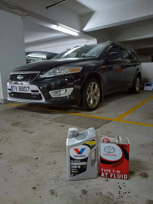

As a side note, when a lot of garages and parts store see what oil I use for my car they were all in horror.....
圖片附件: 279858626_10101011408873177_5840133352536374939_n.jpg (2022-5-17 18:40, 56.2 KB) / 下載次數 36
https://h0.hkepc.com/forum/attachment.php?aid=2320629&k=2cbf573dadb384786376d81ae0237fbc&t=1781474772&sid=OHMTJt91qn
