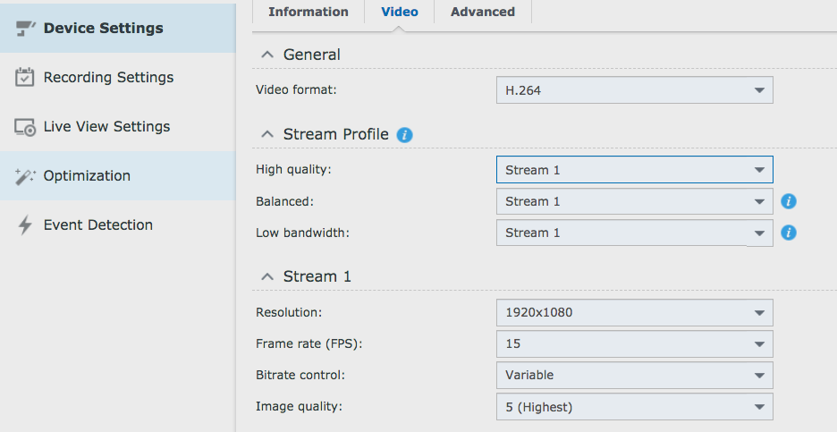

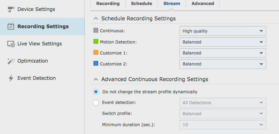

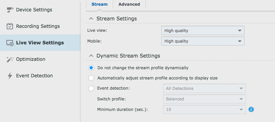

Hi Echen,
I can use GENERIC_ONVIF connect to CAM. However display resolution is 640X480 too lower and can't control any movement. Would you please further advice any setting need?
作者: echen    時間: 2018-10-12 17:22
本帖最後由 echen 於 2018-10-12 17:26 編輯
回覆 7# superfish2010
Some ching asked TPlink CS about PTZ, they advised that PTZ is not the standard of Onvif so control movement is not standard features, I had tried ipcam viewer pro using onvif for this cam also cannot control movement.  only their apps can control.
https://www.hkepc.com/forum/view ... mp;highlight=ipc42a

作者: superfish2010    時間: 2018-10-15 08:56
Hi Echen,
Good! I can change display resolution. Understand that PTZ can't be control . Thanks again of further infomation share!
