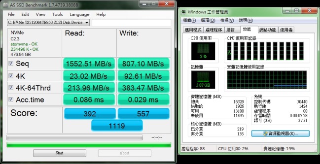

Ok I find CPU load is normal
圖片附件: MTE850_SYS_RE.jpg (2019-8-25 12:40, 81.71 KB) / 下載次數 70

After  you find the PC CPU usage is normal, it almost sure the PC is not affected by Virus!
And the SSD seems not too bad although the benchmark is low (normal NVME able to reach at least score 5000 or above, this is a little bit strange!
As you haven't mention your display card, thought that you are using the IGD of 8700K, go to Intel to have the driver update and see what happens...
If nothing attempt after you make the update, the last thing should be re-install W10, it's boring

照計m2唔會咁低分

個分真係好低
好似無對齊咁

Transcend 個軟件 都冇顯示隻 m.2

Transcend軟件顯示唔到隻 m.2
